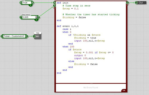

I have found that when I use the "Ticker - Custom" they do not tick when I initially strat the program, I have to go in and remove the "On" check mark and then replace it. Once I do that it works fine until I close the program and reopen it. Any thoughts?

Yeh i came across this a few days ago. It's a simple fix.
Add this line to the code...
output 0,t
Just like i have below with the smilely face.

Re: Custom Ticker not ticking when first starting
Thank you for the reply, I added the line, to include the smiley face, and the ticker would not initially start ticking until I removed and reinserted the check mark in the on box. I even tried it without the smiley face with no better results
That's a clue to the easy way - by doing this you are sending a trigger into the input, causing an event which sets the timer running.dange11 wrote:removed and reinserted the check mark in the on box
So the simplest way to make sure it automatically starts ticking is to simply put an "After Load" (and "After Duplicate" possibly) connected to the same Ruby input as the on/off checkbox.
That will give it the 'kick' it needs to get running at load time.
Ummm.....I'm not getting a result here Myco. It's behaving like the original ticker, waitingMyCo wrote:Try this:
the "step" time before it sends the first trigger. Put in a step value like"1", easier to notice
what i mean.
