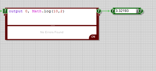

logarithms in ruby - working?
9 posts
Something like this.
Does it requires something else?

Re: logarithms in ruby - working?
Nope, not with array that way.
ruby-log.fsm- (330 Bytes) Downloaded 862 times
- tester
- Posts: 1786
- Location: Poland, internet
you need to do it with each array element, using 'each' in a oneliner like this:
output 0,@arr.each_index{|i|@arr[i]=Math.log(@arr[i],2)}
There is one problem.
At each restart I get an error (see attached pic) and must retrig the module.
- Image1.png (8.94 KiB) Viewed 16236 times
hmm looks like it does the operation on loading, also when you click insideand change space or something it recalculates the array which contains the already processed values, like this the values are getting smaller till they are aout of range (minus)
just put it in an event methode, to only get triggered from input, i think this should solve the problem ( it does here )
Nubeat7 - Posts: 1347
- Location: Vienna
I added afterload/dupkicate triggers for input, works too (no error display in schematic).
