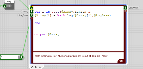

Small issue:
Just trying to log scale an array.
I know what the error message means, but I don't know why it's considered "out of domain" here. What am I doing wrong? Thanks.

Postby Tronic » Sat Sep 20, 2014 11:23 am
The array have negative number?

Postby Perfect Human Interface » Sat Sep 20, 2014 11:58 am
Tronic wrote:The array have negative number?
I think it was all zeros before running the schematic. Of course I had to force-quit after connecting the array to a text box and the schematic became unresponsive (is there a proper way to look inside long arrays? That's really annoying).
Not sure what to do in 0 case. :? Oh wait... I can just set it = 0. -.-
