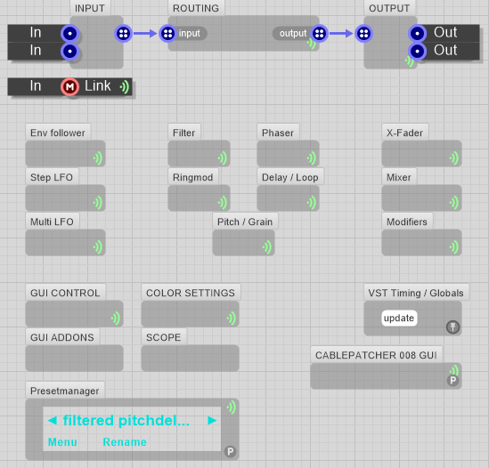

one way i use to avoid deep nesting is, using ruby, 1 code component really can save several green levels..
i also extract all GUI elements from the stream parts so that they are not placed somewhere in the 5th level of some stream modules and you need to go another 5 levels down to change some behaviour of your knob..
the deepest levels in my schematics are normally max 5 levels deep - specially on more complex GUI controls - the stream related modules rarely are deeper than 3 levels anyway...
here for example you can see the first level (directly below the surface) of bondage, from here you can go maximum 4 levels down
about deletion of unused things, sure everything which is not needed should get deleted, also float, integer,or string prims which are through positions (which have an input) are senseless, often its needed in the development phase to control values but all the "watch" elements should get deleted in the release versions, normally it doesn't or shouldn't affect the performance but the size and the loading times, same goes for help texts or info panels which are seen just in FS (use purgeable for things which shouldn't get deleted but not needed)

@Nubeat7,
Thanks for the info and the pictures. This is exactly what i'm trying do now, but decided to abandon well organizing and completely avoid of nesting whenever it possible because I see that it daramatically effects the RAM usage.
My decision effected by the fact that FS's biggest weakness is not the CPU usage but the RAM usage (when working with samples), so to avoid of pops, click, bad sounding multi-samples and random noises that come out from the project whenever a midi sequence is running in the background, the RAM usage must be reduced to the necessary minimum. Saw that the RAM usage threshold in FS apps is about 1gb RAM. whenever this limit is passed, the problems occur because 32bits RAM limitation chokes the project. I wonder if midi processes are effected by nesting as well;
How does FS generates midi processes? Does the midi signal actually recognized by FS as a combination of "green" orders? Because If so, nesting midi components would be a bad idea as well...
