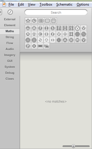

Hello,
In my overview the tag filters are emtpy.
how can i reset it?
how can i reset it?

I stopped using them as there's some kind of bug that makes all or most of the tags disappear. I had reinstalled, which brought them back, but soon they were gone again.

Perfect Human Interface wrote:some kind of bug that makes all or most of the tags disappear.
This has been going on for a while now..even through quite a few FS updates.
I rely on the fix by Walter (god bless him
http://www.dsprobotics.com/support/viewtopic.php?f=2&t=2621&start=10#p14611
The fix is not permanent. Sooner or later the bug will re-appear.
It's a good idea to create some shortcuts to the bug fix procedure,
so it's less of a hassle to do every time the bug re-appears.

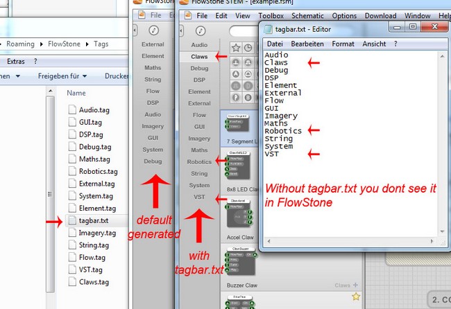

i have writen a little cmd batch tool.
this will generate the tagbar.txt which would not generated automatical.
the problem:
some times FlowStone lost the information for the given tags in the AppData\Roaming\FlowStone\Tags folder.
If you delete the Tags folder, FlowStone create it automatical after open and close of FlowStone.
But it does not generate the tagbar.txt file which is needet for displaying it in FlowStone.
If you create new Tags you have to save the configuration before deleting the Tags folder.
In my example its the Claw.tag
So save the claw.tag
delete the tag folder
start FlowStone and close it
Now copy the saved tags back to the Tag directory
After this you have to start the tag-create.bat file.
This will generate the tagbar.txt in the tag folder.
After starting flow stone you will now see all availible tags
As you see the tags now sorted alphabetical

Hi SonicBe@m,
nice idea but some warning and a little hint from me:
1. If the tag has a space in it's name... only 1st part is listed but wo anything in it...
2. normally all tags are regenerated after restart...
3. some quick .bat changes:
