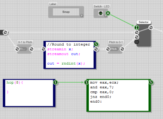

So Martin's fast stream functions worked easy-peasy as shown here.
But I also wanted to try a hop as suggested. Unfortunately I don't know a lick of ASM so pic above also shows how far I got with that.
Is this just a matter of pasting this stuff in the right places or is it more complicated than that? Haha

Perfect Human Interface wrote:But I also wanted to try a hop as suggested. Unfortunately I don't know a lick of ASM so pic above also shows how far I got with that.
In this particular case it is as simple as that. Copy the code between "jnz end0;" and "end0:"
Also make sure that there is no "end0:" in the original code, or there will be doubled label and code will crash (to prevent it, simply rename it).
To explain how hop works:
mov eax,ecx; //copy ecx to eax register
// ecx holds the index of the sample (each sample it increases by 1 )
and eax,7; //this is basically eax % 8 (a binary trick for fast modulo of powers of two)
cmp eax,0; //compare with zero
jnz end0; //if the result was not equal, jump to "end0:"
//here should be the code you want to hop
end0: //this label marks the spot, where the (to be) hopped code ends.
Theoretically it should work as expected, except for obvious reasons when using code in hop (for example filters will be messed up if used in hop)
