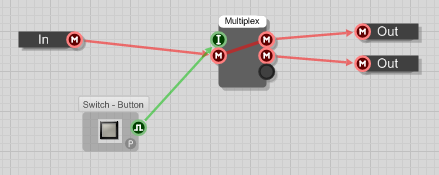

I'm trying to do a sort of MIDI filtering in Flowstone.
Once a switch is clicked, MIDI pass onto a MIDI pin (data that I'll use, linked to another plugin), else on another (a dead endpoint, which nothing will happen).
This is the basic schema:
but once I export it as VST, and I load it on FL Studio Patcher, I can just see 1 output pin. Where am I wrong?
i.e. How can I ignore MIDI once Switch is on?

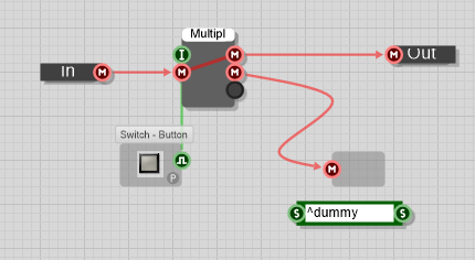

Generally in a plugin you can't have two MIDI outs.
There are 16 channels in one output though.
Hope helps Nowhk
Here is one way to do this->
