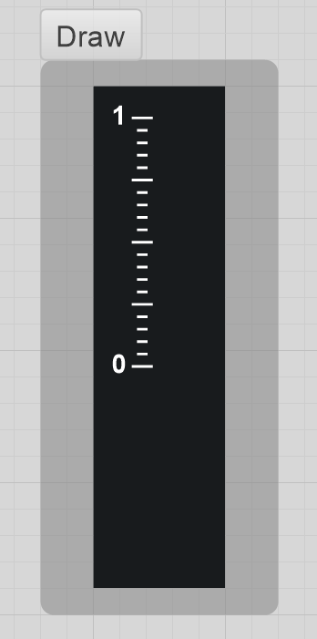

I'm drawing a Meter for my LFO that will show min/max value of it (in my case, 0 and 1). My LFO window/display has not a huge height, so the meter should fit near it. I take the Gauge from "Meter - Positive" module and I've worked on it. This is my result (zoomed in):
Its nice, exactly what I need. But when I use it at real zoom, the lines/text looks steppy:
I've also tried to take the bigger one, resize accordingly in Photoshop (1 point = 8pixels) and reimport as Bitmap, but more or less it is the same (even if certainly better):
My question is: how would you draw this kind of "small" elements? Should I approx the drawing to 0.125 ratio? I've already tried, but nothing change. Also, how would you manage the text later? You have not control there.
Is there a sort of "smooth" function when Drawing? I believe I can draw small things :mrgreen:
Thanks to everybody who will help me!

Postby tulamide » Fri Feb 19, 2016 8:21 pm
Have a look at the user guide, chapter 8, drawing/smoothing
v.setSmoothingMode
Is normally activated, if you switch it off, the draw elements will be aliased, but for clear lines that's what you want. You have to use pixel accurate values then, of course (multiples of 0.125)
v.setTextRenderingHint
this is the same action, but for fonts only.
Read in the user guide about accepted values for the methods.

Postby Nowhk » Fri Feb 19, 2016 10:07 pm
tulamide wrote:Have a look at the user guide, chapter 8, drawing/smoothing
v.setSmoothingMode
Wow. Amazing! It works like a charm. I've used setSmoothingMode in the past, forgot it. And never used that setTextRenderingHint. Thanks dude!
