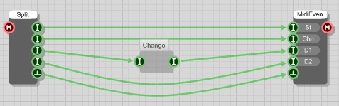

Hi
I was trying to read from midi split and change a certain note to another one, but when changing the notes value, it seems some notes get stuck while playing 2 or more notes.
I'm guessing note off messages get mixed up somehow?
Do we need to hold playing notes in an array manually, or something?
Any thoughts on this?
Father

Postby Father » Thu May 05, 2016 8:22 pm
[quote="Walter Sommerfeld"look at the ruby 'reading/creating Midi Objects' Part in the User Guide! should work fine 4 ur needs![/quote]
I'm actually doing it with ruby. Something like this:
midi_out = Midi.new @original_state,@original_channel,@replaced_note,@original_velo
But i was looking for more information about it how things are working, and how to handle multiple notes.
Father
