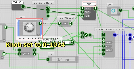

I am using a 100 ticker on the "Do it" on the Array shift ,1024 values for position.
Do i need a faster ticker for faster then realtime render or what am I missing?

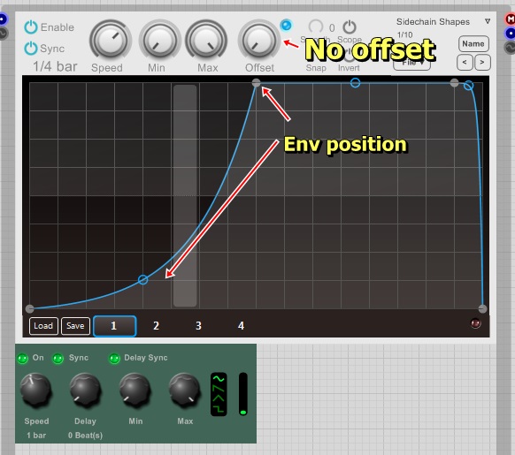

Pre offset.

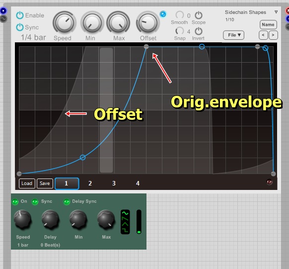

After Offset using a shift array.
Knob is set to 0-1024 values into a "round to nearest" Float to INt to shift the Array.
