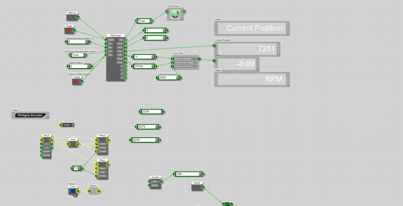

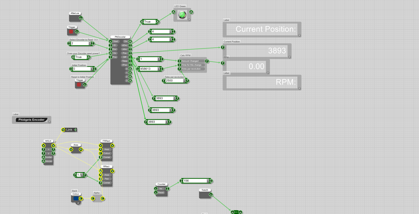

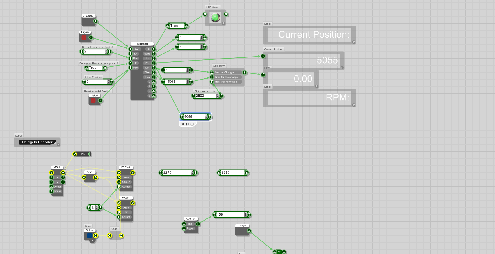

Could you take another look at the Phidget Encoder Module program.
I have the 1057 - PhidgetEncoder HighSpeed hooked up to an E6 US Digital Encoder using Version 2 of the FlowStone PhEncoder program.
Using the Phidget test program "Encoder Position" displays 10,000 ticks with 1 revolution.
Using the US Digital Explorer Test Program "Encoder Position" displays 10,000 ticks with 1 revolution.
Using the FlowStone Program it was noticed that it displays inconsistent readouts on the POS "to the current position of selected encoder "
(see attached file Encoder Example 1.png = 7,211 ticks). This should read 10,000 counter position as the Phidgets and US Digital programs do.
As a test, I added another Float to the output of the current position reads 5,055 (see attached file Encoder Example 2.png).
As another test, I added 2 more Floats to the output of the current position reads 3,893 (see attached file Encoder Example 3.png)
These should all read the current position as 10,000
The "Ticks per revolution" is set at 2,500. The resolution is 4X (the way I understand it, the Phidget board is a 4x). So 2,500 x 4 = 10,000 ticks/revolution. I know "ticks/revolution is redundant, so it could better be said 10,000 positions around the shaft.
Please let me know if any additional data is required to fix this program.
Thanks,
GII
