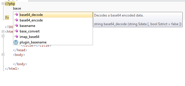

Popup list is i have written a "." (Dot) after any object. In VBA (Access) it looks like that if i'm editing a TextBox:
I'm using that realy often - And also i look often through the list to get a feeling, what i'm able to do this this object

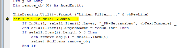

Next one i'm usig verry verry often: Single-Step
For users that do not know: Every time i press F8 the next line will be executed. So i'm seeing whitch way the procedure takes. The Line that is executed next is marked like that: (AutoCAD VBA)

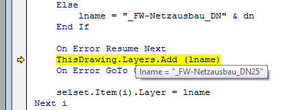

Next one i realy like here is that if i'm moving the curser to any variable with a String or any value a kind of curser-line appears and tells me the variable tat is stored to it: (AutoCAD VBA)
