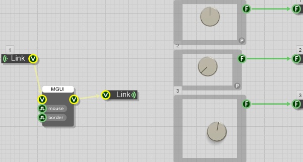

1. Switching panels is easy, use a multiplex with a wireless link into each module.
Then place a wireless into each module that you want to switch, taking care to name them either sequentially or use unique names for each one.
Switch 2.jpg (59.35 KiB) Viewed 21458 times

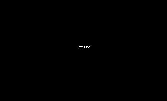

Here is a resize thingy.
Resize.fsm
(70.56 KiB) Downloaded 1285 times

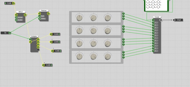

Simple Gui Switch
Simple Gui switch.fsm
(7.79 KiB) Downloaded 1282 times
