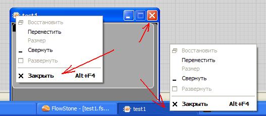

Embedded wrote:you will have to manage your program exit to delete the file before exiting (so disable close on ESC and make your own close button using the EXE Quit module).
How hide (or disable) this elements (and the <Alt-F4>) ?
- quits.jpg (21.29 KiB) Viewed 28198 times
- Shoo
- Posts: 33
- Joined: Fri Sep 02, 2011 8:37 am
- Location: Russia
Re: A one instance
The only way is to use the fullscreen mode.
