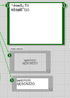

Trog - your module is working for ascii (which does not contains non-english letters), or for non-UTF ("half-size" if I can name it this way) codepages? Because it seems to work with polish letters (as well as FS itself).
And second question would be - this simple encoding system will work for al languages, that use such sort of "half size" codepages? I mean - will it work with everything that FS can handle via it's own stringish greenery?
Now, there is one more interesting thing. While language specific (polish) letters are not displayed correctly in string/text primitives (some sort of other strange characters instead) - they are displayed on labels and editboxes. The picture shows the output after encryption/decryption (input and output are match).
- disp.png (12.3 KiB) Viewed 14221 times

It seems to work because you have happened to get lucky that the code key never exactly matched the value of the upper-ascii letter or it would encrypt to char(0) and terminate the string.tester wrote:it seems to work with polish letters
