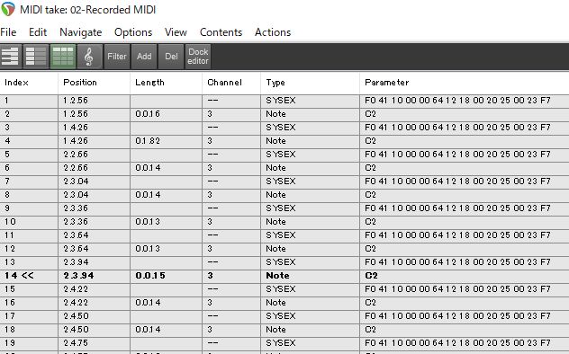

The same problem occurred, when I tried to make a VST for DX7 sysex controller.
As to sysex plugin, I think JUCE is better.
https://forum.juce.com/t/how-to-make-a- ... lved/15231
I tried it. See the picture (VST on Reaper).
If you are interested, I'd upload the c++ source file.
