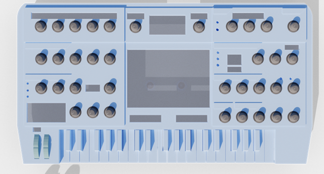

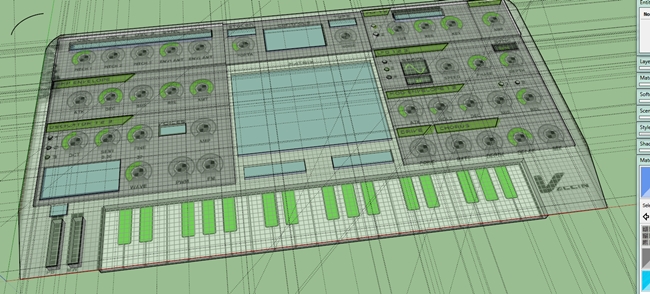

Re: Silly Gui question.
Coming along...Lets see how it translates , very nice to tweak the design in SK
I do have these knobs made for FS as well , still trying to figure out how to replace the originals

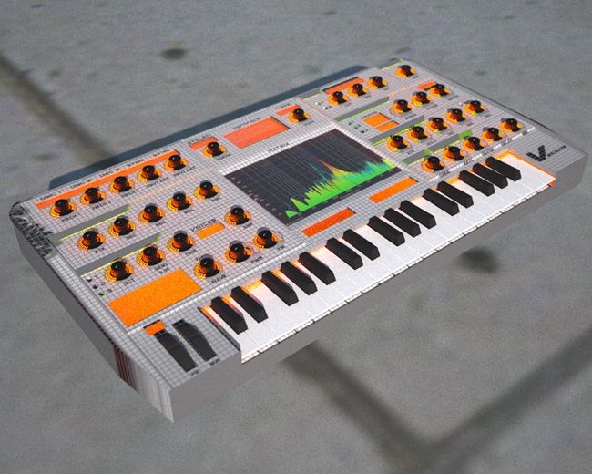

Funny , I kind of like the grid on the exported image/texture from FS.
Orange glow on the screens was a render mistake , kind of cool though.
Now I need to figure out how to make a cool analyser dude like on the mockup.
Any tips , modules for that ?
