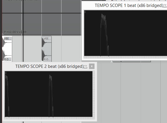

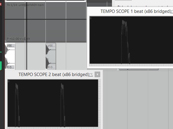

I hit play and it shows up here .
weird 1.jpg (38.93 KiB) Viewed 13373 times
I hit play again and it shows up here.
Weird 2.jpg (36.26 KiB) Viewed 13373 times

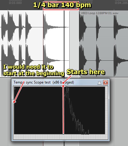

The "problem" for me is getting it to start at the beginning of the scope window.
It is not clear to me if it should do that and just not working or if its designed like this ?
Sync scope.jpg (57.86 KiB) Viewed 13356 times

Still trying to get this to work , but using this approach I cannot get the scope to start at the beginning of the scope window. Basically what I want to achieve is when looping say 2 bars in the daw it will show 2 bars of waveform.
So not a scrolling display and one where it starts drawing at the beginning of the window.
