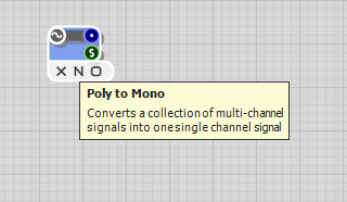

adamszabo wrote:Bug: when you hover your mouse over the poly to mono, in the popup info it says ...into onesingle channel signal. there is a space missing from one and signal. Its the only bug I found
Weird, can't see that.
MyCo - Posts: 718
Re: FlowStone 3.0.9 Beta1
Yeah strange indeed, its like this for me.
- typo.png (7.2 KiB) Viewed 21281 times
