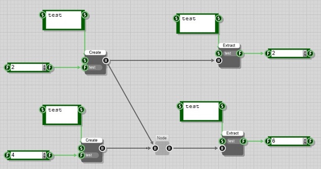

Below is a big questionmark though. I'm still unsure... Does the bus add same-named values together at junction points... or does it only add them together at unpacking? It would make zero programmatical sense that they would add encapsulated values together (at the bus level) from my logic standpoint.
I think I'll have to do a controlled test to make sure how they behave...

Really?...
Well aaaa-all'righty then.
Buses really need a companion prim called "bunching" that does "only" that for using as transport up and down hierachies... I think
Maybe I'm an idiot and have missed some vital logic here. Maybe a big button in FS. Wouldn't be suprised
typical me in that case.
This behaviour doesn't rule out of course the two buses aren't still separate until unpacked
Simple analogy "bus + bus = bus[[2],[4]]"

I make a little test.
(Was also asking myself if adding stream outside of a code was fast as inside.)
We could see the code generated with the analyzer.
It seams the same with link add, asm or buses.
But the micro cpu analyser have a little more for the buses. (not so much comparing to bigger code)
Comparing the text code, with buses there's 2 more line at the end. A read and write.
