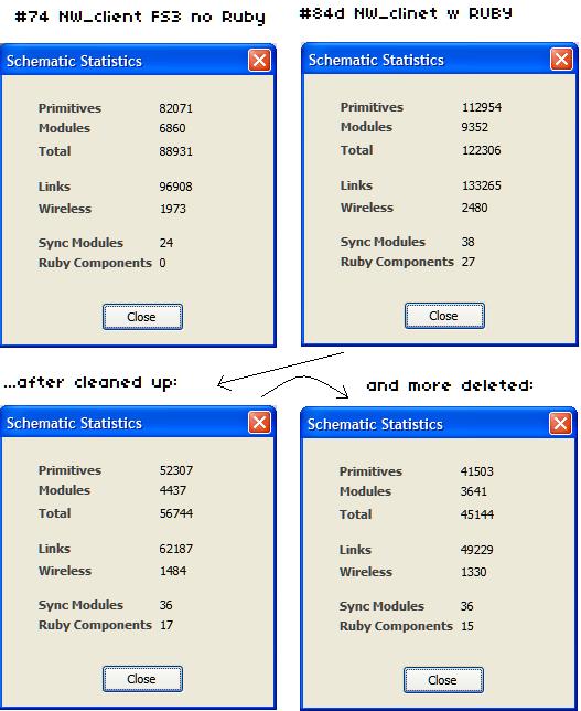

I hoped again with this update i can reduce the CPU use of my projects...
and again have to change many things (trigger behave etc.)
and also tried to get ruby into my old brain:
Now i tested this on my oldie Core Duo and Quads (btw. not every user owns an i7)
FS v1.15 vs FS3:
Even the ruby Level meters halves the comps and Private bytes amount it uses triple CPU power on the Duo and approximate the half of that on the quad (...all w/o the background probs mentioned above)
And the exe is 3.3 MB instead of 1.7 MB in size (ruby overhead - i know...)
FS v1.15 vs FS3:
- NW_client 74-84 statistics.jpg (50.13 KiB) Viewed 37835 times
Re: Big CPU Problem in compiled EXE
Walter, if you email us the two files you're comparing for cpu or post them here we can take a look. You shouldn't be getting any higher cpu in FS3 than you had with FS1.
Thanks 4 ur offer... but:
Back 2 the roots...
Even if my discrete Levelmeters (separate Module for every LED) uses more comps they are my own dev and
very optimized with the help of Trog...
So please try 2 optimize the GDI+ routines or better replace them with a GPU assisted one...
Ruby makes here no difference!
Walter
Back 2 the roots...
Walter
