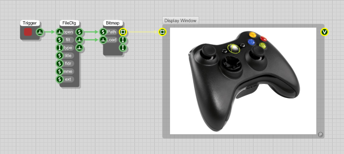

Yes, if you hover the mouse over the component it gives you a description.
Here's an example:
Please note that the component reference is not for modules (i.e components are the base FlowStone building blocks and modules are made using components).
Here's an example:
