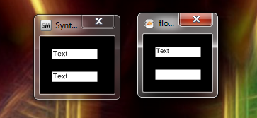

I find it extremely complicated to make a GUI front panel, tried to put borders around objects and background colors, when I tried using background colors they seem to take over the fore ground and hide all my controls on the panel. The other thing I find extremely frustrating that when I use an GUI EDIT BOX when I make an executable and run it it appears that any entries on that edit box go away until I click on another edit box, tried changing the preferences to no avail. Is there a reason as to why guy components don't have frames around them that can be adjusted and be visible when used on an executable? I have uploaded my first program. All I wanted to do was to put a border around all my text boxes and not have my edited text boxes loose their visibility when I click outside of them.

Hi there!
Well i thought it was a Ruby error that was causing this weird switching effect with your txt vanishing from the edit boxes so i imported the old edit box from Synthmaker which does not have Ruby into flowstone and it still happens but, if i export the very same setup out of Synthmaker the effect is gone!
i have exported the two exe's so you can see that SM edit Boxes work in an SM export but not from a flowstone exe proving that it is not you it is a bug in flowstone itself
now you can post a msg for the devs and do your first bug report!
hope this helps
hope this helps
