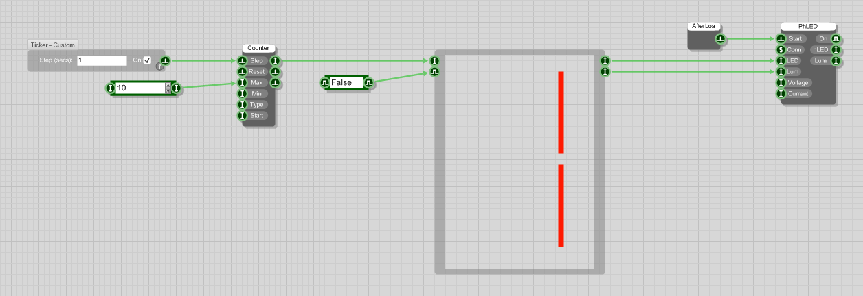

I've had a look, here is the thing:
1. You can only use the Seg. Versions that have a 1 at the end of their part number, something in this format: HDSP-U__1
2. For Red and Yellow versions of this Seg. you should think about using a protections resistor. But it might not be required, because the phidget drives the LEDs in multiplexing mode, so the LEDs only see current peaks.
I'll sketch something together...

Had a quick look at the Phidgets led 64 manual and it says you can connect the leds directly to the board (no resistor).
http://www.phidgets.com/docs/1031_User_Guide
So I guess the hardest part is writing to all of those individual addressed leds.
Try this (not tested) but should get you going:
If you wire them up like this:
LED - Segment
0 - a
1 - b
2 - c
3 - d
4 - e
5 - f
6 - g
7 - dp
LED - Segment
0 - a
1 - b
2 - c
3 - d
4 - e
5 - f
6 - g
7 - dp

You can connect them directly, but then you drive the seg with overcurrent. And as long as you don't know the pulse length that this phidget thing uses, you should avoid that. In my plan, I wouldn't use the connectors 0-7, because the the seg is common anode, and every even LED-Port on the phidget is one anode, and every odd LED-Port is another anode. So I would use 0,2,4,6,8,10,12,14 or 1,3,5,7,9,11,13,15 for one display.
MyCo - Posts: 718
Re: 7seq.digi Display on Pidgets 64LED Board
MyCo wrote:You can connect them directly, but then you drive the seg with overcurrent. And as long as you don't know the pulse length that this phidget thing uses, you should avoid that. In my plan, I wouldn't use the connectors 0-7, because the the seg is common anode, and every even LED-Port on the phidget is one anode, and every odd LED-Port is another anode. So I would use 0,2,4,6,8,10,12,14 or 1,3,5,7,9,11,13,15 for one display.
You won't over current them as the are current limited in the Phidgets Module. There is a current limit input on the FlowStone module, these don't use PWM but use active current limiting ( see Manual). Each of the 64 channels are the same and have an anode and a cathode input (two per connector). However I've not see in the manual which is active, but these devices are usually pull down so if this is the case then a common anode display should work.
