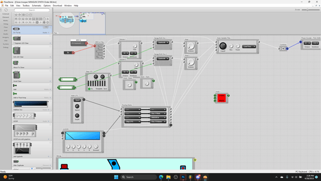

My major problem that stumped me right now is AHDSR Retriggering with my Step LFO. My AHDSR is attached to a pitch in the matrix. My step lfo is attached to the OSC Volume. Goal is to retrigger the AHDSR with the Step lfo so that it constantly shoots the adsr pitch as well as shooting the volume gate.
I just cant figure out how to retrigger the AHDSR with the Step LFO in the matrix. Idk if im attaching things wrong or what but its a major part of this synth and i cant figure it out.
Plz help
Plz help
- Zayne-clone-trooper-synth-fsm-screenshot.png (44.59 KiB) Viewed 16047 times

Could you please post the schematic itself? Then we can offer help.
Cheers!
