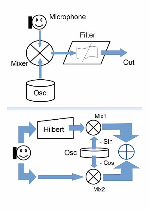

I want to build the following scheme in FS:
Many if not most of you know what amplitude modulation is.
The diagram above depicts a method to mimic the effect observed by radio amateurs in the Short Wave band. This circuit simulates the reception of signals transmitted by SSB modulation.
In my first thread I asked about the upper possible frequency of the oscillators in FS, meaning close to the radio frequency.
And now I want to correct right away that for the above scheme to work it is enough to generate the carrier at frequencies of the order of 20 kHz.
I tried to make an imitation of this Shortwave reception mode myself. But I am very poorly familiar with the principle of the elements and modules in FS.
Nevertheless, I attach my example at the end. Connect it to a DAW, and listen through it any audio file with speech. It's certainly not quite what you need, but a bit like real radio reception.
So, anyone who can help implement the above scheme in FS will be in for a surprise and my thanks!

Graphically, these two methods can be depicted as follows:
The first of these is the filter method.
As the technicians write, its problem is with signal convolution at frequency boundaries, the consequence of which is a decrease in the useful bandwidth. Therefore, in this method significant frequency shifts are possible only with a multistage procedure.
The second method is called phase-shifting, and uses a phase-shifting all-pass filter called the Hilbert Transformer.
The difficulty of such a method is the complexity of such a phase-conversion filter itself. Such a filter gives the desired phase shift only in a limited range of frequencies. That is, for an expressive effect, you will have to apply a group of bandpass filters, each of which must be followed by a Hilbert transformer.

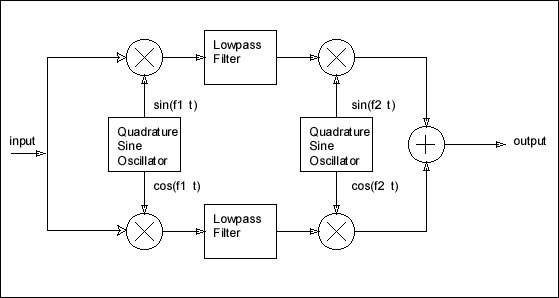

The third method is shown in my diagram in the first post.
Unlike the first two methods, this method does not require any phase-shifting filters, and requires only two quadrature oscillators.
It works clearly and without errors. The low-pass filters can be any kind of the same, and their phase characteristics do not matter.
The frequency shift is performed by adjusting either of the two oscillators. And it is effective over a wide range of frequencies.
Therefore, I ask you to participate, and make this circuit in FS.
Respectfully!

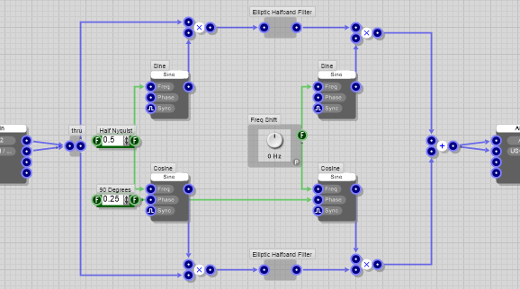

Here is a demo for you. I thought I had posted something similar before, but I can't find it any more. Any way, this is not optimised, but it is fully functional. Have fun with it!
FreqShifter.fsm- (10.71 KiB) Downloaded 512 times
- capture.png (29.52 KiB) Viewed 17448 times

The basic methods are two: filter and phase (with a Hilbert transducer).
Their graphic sketch:
Both are difficult to implement.
The first is the filter method has the problem of signal convolution at frequency boundaries, which reduces the useful bandwidth.
The second, with Hilbert, allows a shift in a very limited bandwidth, and therefore requires several "bandpass filter-phase-shifting Hilbert" stages.
You have done the most difficult implementation.
But my picture in the first post shows a third less known method, which does not require phase-shifting filters, and it needs only two oscillators. It works clearly, and over a wide frequency range. It is the best solution, and easy to implement! The shift frequency can be adjusted by either of these two oscillators.
Thank you for your work!

Tepeix, hi!
You know, Martinvicanek made it work! He made a demo using this scheme, and this simulation works great.
So no more phasing filters!
