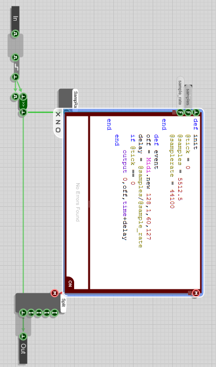

A MIDI ticker->

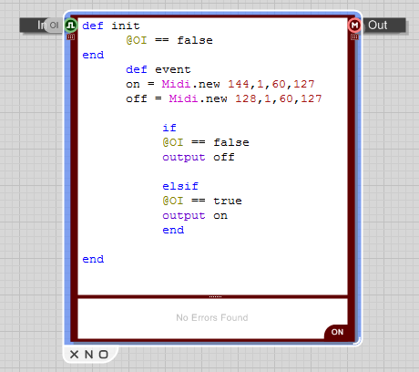

& a note on/off switch->
If you'd like to tell me if these codes should be bug-free,
or what is wrong I would appreciate it.
Cheers, Nick

I see mucked up the init state of @sample_rate by leaving out the _ in the init.
nix - Posts: 817
Re: Are my Ruby codes correct?
In the midi timer @tick is alway zero, so you could remove everything related to it. I don't get what the rest of the schematic does. You generate a Midi event, but don't use it at all... weird.
The Midi-OI(?) code looks way to complicated for what it does... could be done much simpler, like this:
def event(i,v)
output(Midi.new(v ? 144 : 128, 1, 60, 127))
end

Thanks for chopping them down MyCo.
The idea with the MIDI tick is ->
1.It's function is outputting a green tick with the soundest possible timing.
2.It uses the soundcard's clock, the Ruby MIDI syncs to it.
The timing has errors as it goes to green, but they are minimal.
It's usable
3. You can render this in a DAW, as the MIDI will be opened by the DAW.
If you use green triggers, generally they don't render.
I will try the fixes you suggest, much thanks!

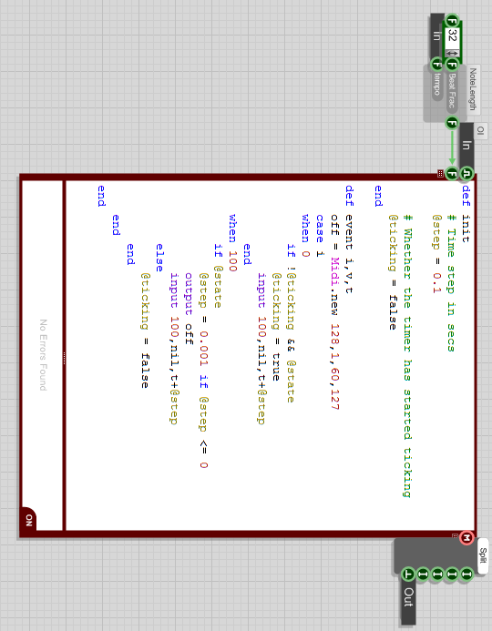

So I modded the custom ticker to send a MIDI note on/off instead of a tick.
I will pm you an example showing the audio discontinuities caused by other operations,
if the little MIDI mod isn't done Trogs. I confirmed it again.
But, {cry} it's equally crashy in Orion.
Here is the new MIDI timer->
Does this code look alright also?
I'm pretty certain this is the single operation that is causing the crashes.
There is one instance of it in each schematic.
edit- Yay--Ruby ticks render, so I don't need to use MIDI, fingers crossed the MIDI stuff is the problem.
