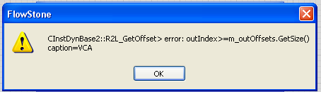

This morning i woke up and opened fs...then open schematic..
added a afterload and s+hold to make sure a value was there on exe start up...
Exe started fine...anyway...back to fs... re-load shematic..
schematic is dead...can't get in....
(this is 2nd time now, in two months, same issue)

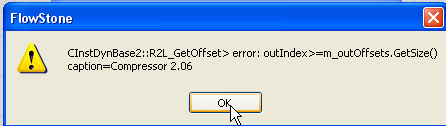

During initializatioI get this... Click it then get this... Click it then get this... I'm accepting that this f##kup is my error, the 'compressor' is mentioned,
the afterload i put it effecting preset ....so I'm thinking that's the cause some how
My Question is, is there a way in to this schematic????
No access and I've lost a few weeks work....as i don't save fsm in very 'small' increments during
development....can salvage most stuff from toolbox....but still have to re-do.....
(Good lesson.....why worry about how many saved fsm's you rack up...can always delete later..)

Re: Dead Schematic
Here is a registry hack you can try.
1. Close FS
2. Extract the attached ZIP somewhere
3. Double click "FS No Autostart Audio.reg"
4. Open your schematic
If this works, fix your schematic and save it.
You can leave this hack active or double click "FS Autostart Audio.reg" when FS is closed, to remove the hack.

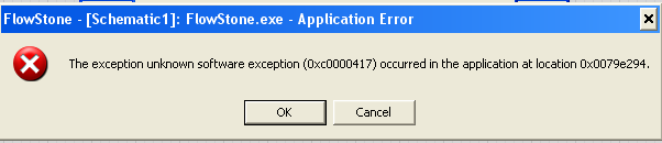

Re: Dead Schematic
Thanks Myco....
Just had first go...or 6...still no go...
here at
then
back to the double click...i go again...crash...but with 'safe start option'
so I try open schematic again...still no go...
still mucking around with it.....
I think i've killed it...
here at
I get default FS Pop up crash report window...and no FSMyCo wrote:3. Double click "FS No Autostart Audio.reg"
then
..still same results as first post..MyCo wrote: 4. Open your schematic
