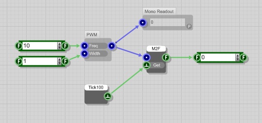

I'm trying to pulse a digital out port on a Phidget interface board, the only way I've found to do this is with the PWM primitive, but It doesn't seem to be working.
Am I doing something wrong, or is there a bug in the PWM primitive?

Yes, this is totally wrong for what you are trying to do! (FYI There was a bug in the PWM but this was fixed in the last version)
The blue connections in FlowStone are dedicated to audio!
The Green stuff is for data!
Here is a very simple pulse project in 'Green' that is ideal to connect to a Phidgets digital output:
pulse.fsm- Digital pulse project
- (515 Bytes) Downloaded 1471 times
