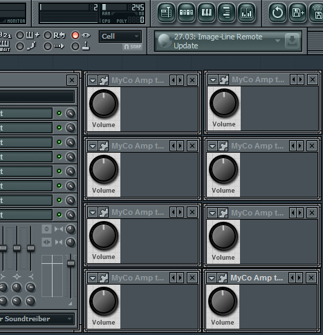

During some test of these days i noticed that Flowstone made plugins are really CPU consuming when they are idle.
Also after ASM optimizing them, they still increase alot of CPU usage also when idle. (from 5-6% to 12-13%).
And for each multi-instance opened these % are added for each instance, resulting to high CPU consuption for each instance.
I belive that this thing requires to be fixed and to performs better or multiple instances will be ever a dream for Flowstone made plugin and also for cheap ones.

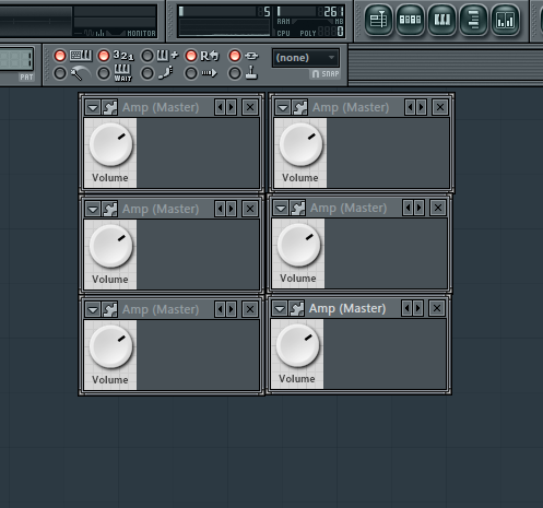

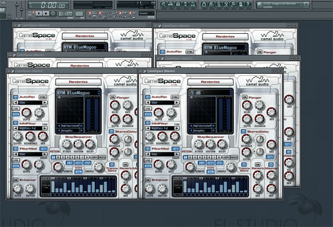

Re: Bad idle CPU consuption
Amp x 6 : 5%
Camel Audio Camel Space x 6: 2%
Im running Intel Core i7 3770k, win 8.1 PRO 64bit.
Chamelspace just disables the audio processing, when there is silence for some seconds on the input... as soon as you put something through, the CPU shoots up and stays there... after some seconds it goes down to idle mode.
This has nothing to do with FS, the chamelspace devs just wanted to squeeze out any tiny bit of CPU. You can build that into a FS Schematic as well, just don't use the standard "always processing" method.
