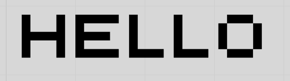

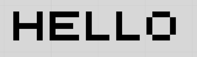

I created a pixel font, but found FS can't seem to render it correctly. It should be pixel-perfect, but it's blurry. Font size is set to 1, no alignment setting, style is "regular." It simply doesn't line up to pixels.
Not only is the placement of the text off but the spacing is too. So no hope of fixing it by setting x/y with area to float.
It should be exactly 1 pixel between each character. You can see it's a little wider.
This font renders perfectly in Photoshop, no problem.
Not expecting a fix for this, but I thought I would at least point it out. I'm not sure if this has any real effect on most other fonts. It is kind of a bummer though as it means I can't do what I was hoping to without rendering out all the characters and then writing a code to draw them all out.
