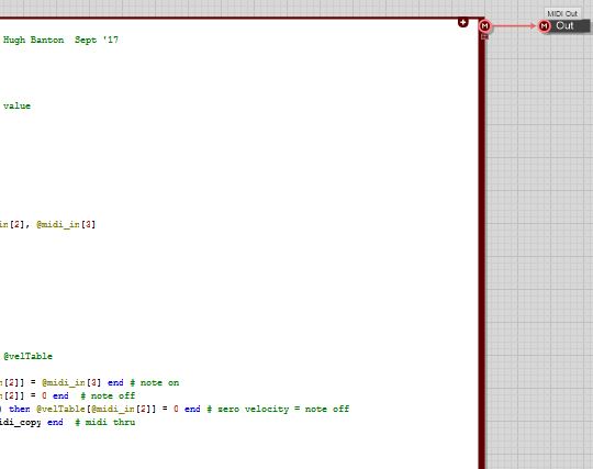

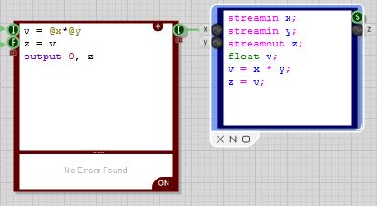

ruby directly to stream>>

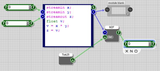

All pictures above are generalizations, not specific examples.
