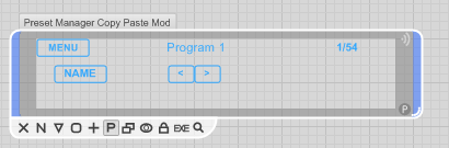

I have a preset manager i edited. And when click menu or Rename. or even the < > I get this selector menu with presets all time.
I cant find the problem.

You've got all Preset Manager sub-modules, stacked on top of each other.
So no matter where you click, the Selector menu will activate.
Move the re-name and <> selectors down, like this
To understand why this all happens, investigate all MGUI circuits in the Preset Manager.

Ah ok so u cant have the preset manager like that?

Used an old one I had lying around so not the same as yours, no copy paste, and the property's panel is messed up
but shows it can be done.

Nice bro i will check
It seem its possible like u did.
