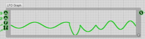

I make an LFO plugin that make random shape, and works on (max) 1280 discrete values, getting a smooth shape. This is a generated 500 values shape:
Once got it, I need to iterate these values; than output (index and the value in my case) at each step:

Nice approch! The problem is that I would to "show" the shape how it will be, than "play" it with a progressive bar.martinvicanek wrote:Why don't you use stream? The CPU hit is not that bad.
Mem type is "dynamic", so I think I couldn't show what the signal will be and the draw a progressive line on it.
Or is there a way? Such as this:
http://www.fastswf.com/CumhxmY
P.s. how do you generate that "consecutive" random array? I see no heavy jump between points...

Dammit, Tronic beat me on that one!
Oh, I chose some random partial amplitudes and iFFTed them, so the result is smooth and periodic. However, if the period is long enough (>10s) then the ear won't recognize the repeating pattern.Nowhk wrote:P.s. how do you generate that "consecutive" random array? I see no heavy jump between points...
