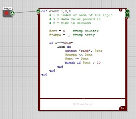

Hi,
Is it possible to build a slow Ruby Ramp generator?
I have looked on the forum and tried to make one in Ruby but it crashes, pretty much on every try...
I need to make many random ramps that are slow, and was hoping I could do it in Ruby. I landed doing it in the DSP, but was wondering if slow waveforms can also be generated in Ruby as well ? ? ? And by slow I mean about 10 samples per second or so...
I forgot to save before I ran it - it crashed, but I took a screenshot
Thanks for any help or suggestions,
Aron
Aron

yes, this can be done. However, I'm not sure what you're trying to achieve exactly, so here are my few attempts:
1. From the image I see it seems you what to generate a wavetable for a ramp.

I entered the Ruby code and while it produces an output it is not a ramp. I am still working thru this... a few of the code lines do not make sense to me at all, but I AM NOT a Ruby coder, but I am learning.
The input 99 is a callback to the input for ???
Here is my code...
does this look correct? It just seems complex for something like an up counter, but again I am not a Ruby coder
And to answer a previous question, I need a float output NOT an array... I can get the array version working, but not the "Streaming Green" version.
Thanks again,
Aron
