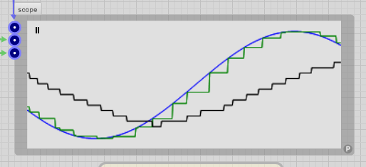

Hello;
Im trying to make a LFO with float output to use this for commanding knobs.
seems obvious but...
i monitor the result with scope (cf shematic)
but with classic signal to float i get an awful stepped curve
with signal to float + (various) de zipper-smoother I get stepped curve with less visible step, but loss of the amplitude, and phase decay (anyway not a smooth suite of float)
searching forum i saw (approx) "mono to float is known to be approximative, but it is easy to make ruby conversion"
well it is not easy to me...
if someone could help
(or if there is something else to make without ruby)
Thanks

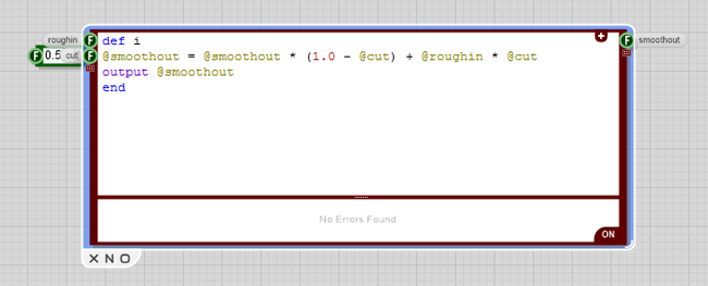

Re: lost in ruby (mono to float)
I think you need something like this, but I can't get it to output anything->

Hi Nix.
Here is a scope trace directly from your example. You can see the sample time period from green is inconsistent. As I undertand it whenever you go into green you'll ht this issue. You can see the conversion from the 2 positive-going edges are significantly different as a result.
- Green sample timing.png (14.28 KiB) Viewed 26062 times

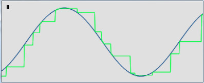

I am certainly not arguing that the floats are hifi,
they are 500hz.
Here is the higher samplerate realized by turning slide on,
which is surprising IMO-->
they are 500hz.
Nix, I understood that the max rate of green was typically about 65 Hz and it varies quite widely, not 500 Hz. Maybe tulamide or someone can confirm that .
I got similar results just using the stock de-zipper. If you increase the "slide rate" it performs like a filter with phase shift, as per your trace, which looks like about 90 degress. I tried putting in a HUGE time for smoothing then amplifying the output also by a huge amount but the result is still steppy at the higher frequency end. I assume it's still steppy because the green timing is unstable.
I don't do Ruby but I can't at present see how to get around the Green timing barrier, if the final result has to be output in green.
It would be nice be wrong on this one

I can reconstruct an approximate sine probably in blue, after the m2f
edit- here I have made the Ruby simpler,
do any of you think it could use less CPU somehow?-->
also allowing a greater steadiness in periodicity.
Here is the 500 hz:-
Is there a stock green dezip?
I only have the blue one atm.
