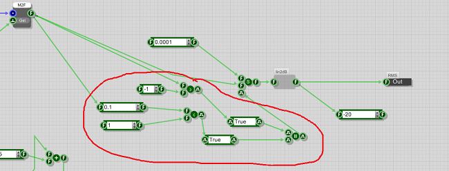

Also Trog, Here is a pic of how I checked for the INF problem.
Ignore the mess of the stuff out the red circle but see how I get a false when I get a INF. . .

Not to sure wth the INF example - the idea is right, to eliminate values that go out of range, but without knowing what comes before and after, it's hard to say if it is the best solution - often you can get away with using min and max modules to do this using a few less components (but not always!).

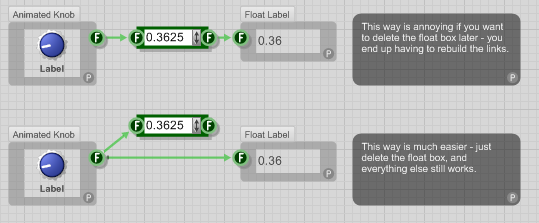

One bit of advice though - if you need to peek at a value to see what it's doing, don't connect the little green boxes in line - connect the bits together directly, then put the readout to one side. That's because they suck up a bit of CPU power, calculating the text to display etc., so they're best deleted when you're done with them. It's a lot easier to delete them if you don't have to re-build the links afterwards...

And yeah, the INF prob is still a problem. It was just a way of getting around it really. Still not a fix
I think im going to try fiddle around with the DSP code a bit but im used to Ruby's clean lazy syntax lol!

The INF thing can be tricky because really you need to find out exactly where that value is coming from (i.e. could be buried inside some code somewhere). Usually it will be a divide by zero - but sometimes you get zero's coming from odd places that you wouldn't expect. As your gizmo looks to be an RMS of some kind, I'd suspect maybe a log() function - there's no correct log value for zero or negative numbers (though sometimes you get zero out of them, which is not mathematically correct, but simpler to deal with in code), so possibly you need to put an ABS or MAX somewhere.
