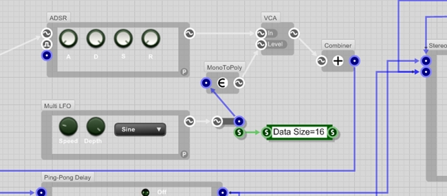

This is what I am trying ....this just kills all sound
- green.jpg (109.16 KiB) Viewed 26053 times

I got it working by pluggin the output into the ADSR VCA but I am still getting the poly behaviour.
Using a combiner to mono and then mono to poly does not work.

You are still doing it wrong. Your lfo is still white, then you change it to blue, and white again. Connect the lfo directly to the mono to poly, so the lfo is blue, then you can connect it when its white.
