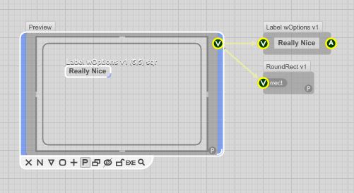

Re: Get Object Location
Postby aronb » Mon Mar 15, 2021 1:17 am
P.S.
You can see that information during and while positioning objects... the trick is how do I get at it?
In this example "Label wOptions v1 (5,5) sqr" is shown, and is the upper left corner of the insert point.
Position
Thanks Again!
Aron
