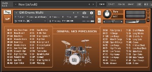

Postby S1User » Thu Sep 29, 2022 6:21 pm
Thanks, but I don't need ADSR. I have a collection of drum samples and all I want to do is trigger them via midi and have them go to individual audio outputs in my DAW so they can be individually processed and mixed.
I have the same drum samples in a Kontakt kit that I created, and Kontakt is literally doing nothing to the samples but triggering them. I just want to move that kit to a standalone VST plugin
