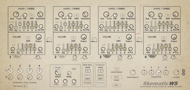

including a new one - SkematicWS :
SkematicWS copy.jpg (206.19 KiB) Viewed 19885 times
which is similar to SkematicSP (which uses Martin's Spread Partials osc), but uses the Spread Partials' predecessor, Martin's WaveShape osc, which seamlessly morphs sine to a saw-like shape. SkematicWS has two of these per 'osc' so can produce pulse waves also and has a Saw/Pulse crossfader. Though the SP osc can also produce this saw-like shape, it has no phase input, so can't do pulse and can't do 'FM' (phase modulation). With SkematicWS, osc 1 can FM 2, 2 can FM 3 and 3 can FM 4. Includes a few simple 'demo' style presets.
