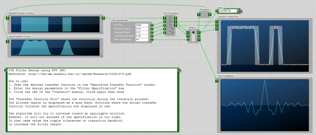

This reference was mentioned in a recent discussion over at KVR regarding FIR Filter design. Below is an implementation in FS, it is quite easy to use and fun to play with. So far it only generates filter coefficients and shows transfer functions, I haven't plugged it into an actual FIR filter yet. Comments appreciated.
FIR_Iteration.fsm
(126.69 KiB) Downloaded 1817 times
martinvicanek
