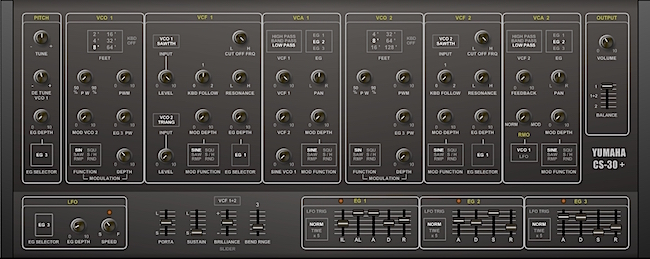

Decided to do two alternate versions of this. The original, in the first post has been updated with almost three dozen presets (those from the Yamaha CS-30/30L patch book, plus a few of my own)
and has been re-named CS-30L +.
Alternate version one has a simple step LFO added, to push it a little closer to the CS-30. This now has the name of the original version : CS-30 +.
Still has the additional performance controls of the CS-30L that the CS-30 lacked ('Brilliance', which opens and closes both filters together, and 'Sustain', which despite it's name actually extends the release time of all three envelopes.)

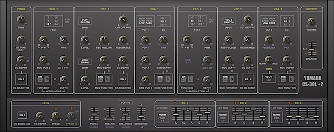

Alternate version two has in place of the step LFO, an auxiliary 'LFO B', which shares the same wave selectors at each target; targets can choose LFO, LFO B or equal mix of the two. For those who just can't abide having just one LFO, and don't need a sequencer (especially a very limited one) built into a synth.
In all three versions I've made the Portamento, Sustain and Brilliance controls alternately controllable by the mod wheel, aftertouch, foot pedal, breath or pitch wheel. Yamaha clearly intended these controls to be used during performance, and placed their sliders just to the left of the keyboard where most synths had/have p-bend and mod wheels. The CS-30/30L had no mod wheel, and a sprung lever in place of a pitch bend wheel. Since mouse-ing an on-screen slider with the left hand while playing the keyboard with the right is no small challenge for even the most ambidextrous among us, being able to control these functions with some kind of MIDI hardware controller is as close as we can get to the way one would play the hardware synth. For example, one could choose aftertouch to control Brilliance, the mod wheel for Sustain, and a foot pedal for Portamento time.
As a concession to modern expectations, I've included a switch to redirect the LFO through the mod wheel.
Though I resisted the temptation to load these up with 'goodies' they do have the following added:
- Both oscillators have Triangle available (as in the CS-15).
- Both oscillators can have their pulse widths swept by any of the EGs or external controllers (just 'cause I love the sound of an envelope sweeping pulse width; something ARP always included in their instruments, and a key element of several of the Pro Soloist's presets).
- Osc Sync (and therefore a selector to send p-bend and Pitch EG to either or both oscs).
- Feedback around VCF 2 (fattens the sound a good deal, but use with caution).
- Output 1/2 Balance can be controlled by an external hardware MIDI controller.
- Both VCAs have panpots.
- In place of the LFO 'Ext' 'Function' selection (output of an envelope follower fed by the external audio input) there is Martin's lovely smooth random LFO waveform.
- The VCFs' input selectors have more sources available.
