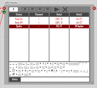

=> Ooops: "Double L-click a SysEx message to show a complete dump." only shows blank - tested with sysex in FS 3.06
also "Double L-click a regular 3-byte message in the main display to open a text box showing its bytes in hex." shows nothing here...

I've just had a thought what might be the problem with the invisible SysEx dumps in the MIDI Monitor. The hex display uses a different font than the one selected for the main window, because it needs to be a fixed width font. I may have chosen something which not everyone has installed.
I've uploaded a new version to the top-post which has properties added for the hex view font and font size. Even if it doesn't fix the problem, they really ought to have been there anyway!

Well - i thougth about wrong font too...
But had less time to look into ur schematic further.
Now we are closer - see pic...
Changed Marlett font to my now favorite Calibri - et voila: works fine

Thanks, Walter - it's good to know that the simple fix worked. After all these years coding, I really should know better than to use "magic strings" buried in the code instead of easily-discovered config constants or properties!
