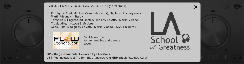

Well I guess it comes down to sampling, yes. Anyways, here's the new version:
Here's the changes I made to the look:

OK, so If You'd like a preview, here's the next version which works fine - but it's so much better looking.
Now I guess i need to perfect the math, make a simple horizontal line VU meter that looks like analog/digital combo to go behind My gauges and then I'll make an average peak, average lesser dB as well as average high and low. These things are really important for professionals to have.
Here's the Images (click to see larger in new window):
And here's the schematic:
And now even humbly I can say that this thing is one of the best VST plugs ever made and it sounds so sweet. It'll be even better with ordered plugins and 50 presets too. I'll literally match like 50 of the greatest songs by michael jackson etc and the weekend so that people can reference with class.
