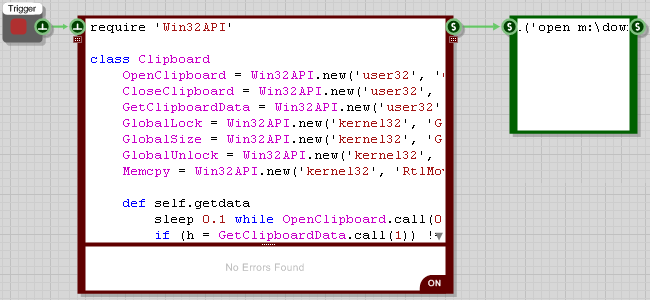

Postby JB_AU » Thu Nov 13, 2014 3:30 pm
Paste from clipboard
Paste.fsm
(659 Bytes) Downloaded 1206 times

Postby Walter Sommerfeld » Thu Feb 05, 2015 3:31 pm
Hi JB,
Why isn't this working in my compiled EXE (v3.06/3.07) ???
I also added optional a WIN32OLE modul for a WMIC cmd... this even crashes the App/Exe... :(
Please HELP!

Postby JB_AU » Thu Feb 12, 2015 12:06 pm
WIN32OLE is not properly supported.... yet! :twisted:
It has taken months just to get GDI32 partially implemented, will get to OLE someday.
WIN32OLE is not a requirement to use WMIC.
3.0.7 Adds a new dimension to my nightmares :cry:
Really busy with some big projects at the moment, i will return, did you see my aRest post ?

Postby Walter Sommerfeld » Fri Feb 13, 2015 12:17 am
...sadly
fine - but why dosn't the clipboard only work in FS but not in my EXE
I know but it pipe into clipboard ;)
here too... :( i use 3.06!
Yeah - had a look - have some arduino board here laying around somewhere... maybe there is a use for it?
cu
Walter

Postby JB_AU » Fri Feb 13, 2015 11:09 am
What are you trying to do exactly, paste text, bmp, audio ?
I possibly need a refresher!
I wrote this in 3.0.5 & haven't used it since.

Postby JB_AU » Fri Feb 13, 2015 11:26 am
Paste.fsm
(659 Bytes) Downloaded 1169 times
I think this is from 3.0.5 and works when compiled in that version, what changed in 6 & 7 ? & Why???

Postby Walter Sommerfeld » Fri Feb 13, 2015 2:48 pm
"/C WMIC /Output:CLIPBOARD logicaldisk where "drivetype=3" get deviceid, volumename /FORMAT:CSV"
I just wanted to avoid the temp file creation and loading...
it works already with piping into file (as usual) in the Roaming folder but... not the fastest/secure way...
Keep on doing!
Walter
P.S.: Please contact malc because of this problem - thanks
