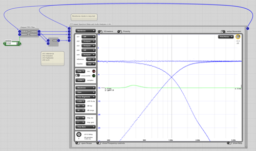

With lambda = 0.52 the filter got warped for Fc becoming 1 kHz instead of 3 kHz when not warped.
The blue curves are : lowpass, highpass, sum.
The lowpass magnitude looks good. One can say that the 3rd-order slope is still there, however the transition band looking a little bit soft. Remember, there are only 31-taps.
The highpass magnitude look perfect. The 3rd-order slope is perfectly there.
The sum magnitude looks perfect. All frequencies are there, at 0 dB.
The green curve is the impulse response of the selected output. This is where it gets tricky.
The lowpass impulse response looks encouraging. The impulse response shows almost no preshoot and no ringing.
Worth noting is the apparent group delay, about 1 millisecond.
Remember this is a lowpass filter. The high frequencies don't appear here.
