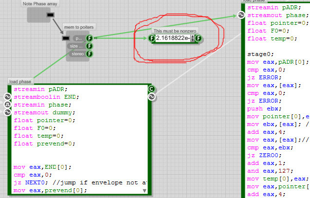

the pointer module should output nonzero value.
- memtop.png (57.99 KiB) Viewed 34133 times
