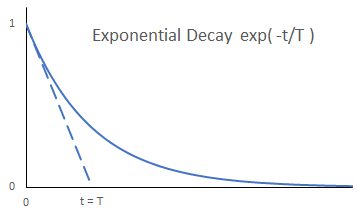

Exponential Decay
Unlike linear decay, exponential decay is never really "done". So how can we assign a characteristic "decay time" in that case?
Consider the expression
a(t) = a0*exp(-t/T)
There is this time constant T which is a measure of how fast things change. If the decay continued at the initial rate, then it would be complete by the time t = T (dashed line in the image). Since the decay is exponential, however, at t = T the amplitude is still at roughly 37% of its initial value.
There are other possibilities to characterize exponential decay times. Some common examples are:
1. Half-life T_1/2 in radioactive decay. Obviously that time is shorter than T. The relation is T_1/2 ≈ 0.69*T
2. Decay to ten percent is after T_10% ≈ 2.3*T
3. In reverbs, it is common to state the time forthe reverb tail to drop to -60dB. Assuming an exponential law, that duration is T_60 ≈ 6,9*T
So you see, there is no unique definition.
a(t) = a0*exp(-t/T)

Re: Exponential Decay
martinvicanek wrote:Unlike linear decay, exponential decay is never really "done". So how can we assign a characteristic "decay time" in that case?
a(t) = a0*exp(-t/T)
My expo module has four inputs:
A: Attack, linear rise time in samples (rounded to a multiple of 16).
D: Decay, exponetial decay time T in samples (rounded to a multiple of 16). Note that decay is not to zero but to the sustainn level.
S: Sustain level, a number between 0 and 1.
R: Release, exponetial release time T in samples (rounded to a multiple of 16).
If yo prefer to supply seconds instead of samples, you can convert seconds to samples by multiplying the time in seconds by the sample rate.
Thank you Martin. I understand the problematic. With attack being linear, my first question has been answered instantly. The time advice is very important for me. Just to make sure, I'm not making a mistake:
If I would want an exponential decay towards sustain of 20 seconds (at 44.1 kHz), I'd pass 882000? Likewise, exponential release time 35 seconds, I'd pass 1543500?
