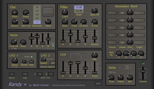

And here's Randy + with the Noise EG :
Randy +_k.fsm
(607.03 KiB) Downloaded 1056 times
Randy +_k copy.jpg (172.44 KiB) Viewed 19960 times

Here's Randy + with the Noise EG and a dedicated Modulation Envelope:
Randy +_k3.fsm
(639.48 KiB) Downloaded 1022 times
Randy +_k2 copy.jpg (179 KiB) Viewed 19747 times

As Noise has it's own filter, it might be useful sometimes for noise to bypass the main filter.
Like a switch in the Noise section.
What do you think guys?

Yeah, I'd like to hear Martin's thoughts on the Noise routing. It goes through hell on it's way to the output :shock: ;) - first it's own comb filter, then the main Filter and finally the Spectral Tilt filter, which the way Martin did the original GUI layout would lead one to think is only affecting the oscillator/s.

By the way... I've noticed that Tilt knob has max signal level around 0.5 and the level greatly drops close to 0 or 1.
Just theoretically, is it possible to compensate, so that level will keep the same through the whole Tilt knob rotation diapason?

I had other thoughts about this, such as providing the option of bypassing the EG (as in the original), shaping by the VCA EG instead, re-routing the Noise through the Comb Filter only, the main Filter only, bypassing the Spectral Tilt, etc., but any further tinkering would have to be done by Martin. 8-)
